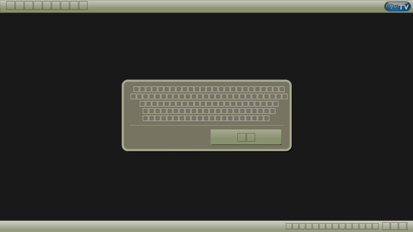

Phew, I'm now at the "missing fonts" step :)
http://www.smovs.dk/htpc/mythtv-setup_qnap__no_fonts.PNG
Any tips on how I at least get some sort of fonts?

Postby ybot » Wed Feb 08, 2012 6:04 am
nkh wrote:Any tips on how I at least get some sort of fonts?
Can you post the log output of mythtv-setup? That might provide some clues.

Postby nkh » Wed Feb 08, 2012 1:51 pm
This is what I get in the console:
Code: Select all
# mythtv-setup
QIconvCodec::convertFromUnicode: using Latin-1 for conversion, iconv failed for BOM: Bad file descriptor
QIconvCodec::convertFromUnicode: using Latin-1 for conversion, iconv_open failed
QIconvCodec::convertToUnicode: using Latin-1 for conversion, iconv_open failed
2012-02-07 21:28:24.753 Using runtime prefix = /opt
2012-02-07 21:28:24.755 Using configuration directory = /root/.mythtv
2012-02-07 21:28:24.760 Unable to read configuration file mysql.txt
2012-02-07 21:28:24.761 Empty LocalHostName.
2012-02-07 21:28:24.762 Using localhost value of 5P0-QNAPTS419P
2012-02-07 21:28:24.942 New DB connection, total: 1
2012-02-07 21:28:25.009 Connected to database 'mythconverg' at host: localhost
2012-02-07 21:28:25.049 Closing DB connection named 'DBManager0'
2012-02-07 21:28:25.053 Connected to database 'mythconverg' at host: localhost
2012-02-07 21:28:25.097 Current locale en_US
2012-02-07 21:28:25.098 Reading locale defaults from /opt/share/mythtv//locales/en_us.xml
2012-02-07 21:28:25.450 DPMS is not supported.
2012-02-07 21:28:25.711 Loading en_us translation for module mythfrontend
2012-02-07 21:28:25.725 LIRC, Error: Failed to connect to Unix socket '/var/run/lirc/lircd'
                        eno: No such file or directory (2)
2012-02-07 21:28:25.726 JoystickMenuThread: Joystick disabled - Failed to read /root/.mythtv/joystickmenurc
2012-02-07 21:28:25.974 Using Frameless Window
2012-02-07 21:28:25.975 Using Full Screen Window
2012-02-07 21:28:26.134 Using the Qt painter
2012-02-07 21:28:26.796 MythFontProperties, Error: Failed to load 'Liberation Sans', got '' instead
                        Location: /opt/share/mythtv/themes/Terra/base.xml @ 6
                        Name: 'basesmall'       Type: 'fontdef'
2012-02-07 21:28:27.556 MythFontProperties, Error: Failed to load 'Liberation Sans', got '' instead
                        Location: /opt/share/mythtv/themes/Terra/base.xml @ 11
                        Name: 'basemedium'      Type: 'fontdef'
2012-02-07 21:28:27.656 MythFontProperties, Error: Failed to load 'Liberation Sans', got '' instead
                        Location: /opt/share/mythtv/themes/Terra/base.xml @ 15
                        Name: 'baselarge'       Type: 'fontdef'
2012-02-07 21:28:27.677 MythFontProperties, Error: Failed to load 'Liberation Sans', got '' instead
                        Location: /opt/share/mythtv/themes/Terra/base.xml @ 19
                        Name: 'baseextralarge'  Type: 'fontdef'
2012-02-07 21:28:27.678 MythFontProperties, Error: Failed to load 'Liberation Sans', got '' instead
                        Location: /opt/share/mythtv/themes/Terra/base.xml @ 28
                        Name: 'basesmallbrown'  Type: 'fontdef'
2012-02-07 21:28:27.679 MythFontProperties, Error: Failed to load 'Liberation Sans', got '' instead
                        Location: /opt/share/mythtv/themes/Terra/base.xml @ 32
                        Name: 'basesmallgrey'   Type: 'fontdef'
2012-02-07 21:28:27.680 MythFontProperties, Error: Failed to load 'Liberation Sans', got '' instead
                        Location: /opt/share/mythtv/themes/Terra/base.xml @ 36
                        Name: 'basesmallpurple' Type: 'fontdef'
                        Location: /opt/share/mythtv/themes/Terra/base.xml @ 40
                        Name: 'basesmallblack'  Type: 'fontdef'
2012-02-07 21:28:27.681 MythFontProperties, Error: Failed to load 'Liberation Sans', got '' instead
                        Location: /opt/share/mythtv/themes/Terra/base.xml @ 44
                        Name: 'basesmallyellow' Type: 'fontdef'
2012-02-07 21:28:27.682 MythFontProperties, Error: Failed to load 'Liberation Sans', got '' instead
                        Location: /opt/share/mythtv/themes/Terra/base.xml @ 48
                        Name: 'basesmallgreen'  Type: 'fontdef'
                        Location: /opt/share/mythtv/themes/Terra/base.xml @ 52
                        Name: 'basesmallblue'   Type: 'fontdef'
2012-02-07 21:28:27.683 MythFontProperties, Error: Failed to load 'Liberation Sans', got '' instead
                        Location: /opt/share/mythtv/themes/Terra/base.xml @ 56
                        Name: 'basesmallred'    Type: 'fontdef'
2012-02-07 21:28:27.684 MythFontProperties, Error: Failed to load 'Liberation Sans', got '' instead
                        Location: /opt/share/mythtv/themes/Terra/base.xml @ 60
                        Name: 'basemediumgrey'  Type: 'fontdef'
2012-02-07 21:28:27.685 MythFontProperties, Error: Failed to load 'Liberation Sans', got '' instead
                        Location: /opt/share/mythtv/themes/Terra/base.xml @ 64
                        Name: 'basemediumgreen' Type: 'fontdef'
                        Location: /opt/share/mythtv/themes/Terra/base.xml @ 68
                        Name: 'basemediumred'   Type: 'fontdef'
2012-02-07 21:28:27.686 MythFontProperties, Error: Failed to load 'Liberation Sans', got '' instead
                        Location: /opt/share/mythtv/themes/Terra/base.xml @ 72
                        Name: 'basemediumpurple'        Type: 'fontdef'
2012-02-07 21:28:27.687 MythFontProperties, Error: Failed to load 'Liberation Sans', got '' instead
                        Location: /opt/share/mythtv/themes/Terra/base.xml @ 76
                        Name: 'basemediumbrown' Type: 'fontdef'
2012-02-07 21:28:27.688 MythFontProperties, Error: Failed to load 'Liberation Sans', got '' instead
                        Location: /opt/share/mythtv/themes/Terra/base.xml @ 80
                        Name: 'baselargebrown'  Type: 'fontdef'
2012-02-07 21:28:28.241 MythFontProperties, Error: Failed to load 'Liberation Sans', got '' instead
                        Location: /opt/share/mythtv/themes/Terra/base.xml @ 502
                        Name: 'datefont'        Type: 'fontdef'
2012-02-07 21:28:28.264 MythFontProperties, Error: Failed to load 'Liberation Sans', got '' instead
                        Location: /opt/share/mythtv/themes/Terra/base.xml @ 506
                        Name: 'timefont'        Type: 'fontdef'
2012-02-07 21:28:30.371 MythFontProperties, Error: Failed to load 'Liberation Sans', got 'Fixed' instead
                        Location: /opt/share/mythtv/themes/default/base.xml @ 11
                        Name: 'basetiny'        Type: 'fontdef'
2012-02-07 21:28:30.373 MythFontProperties, Error: Failed to load 'Liberation Sans', got 'Fixed' instead
                        Location: /opt/share/mythtv/themes/default/base.xml @ 36
                        Name: 'basetinyred'     Type: 'fontdef'
2012-02-07 21:28:30.376 MythFontProperties, Error: Failed to load 'Liberation Sans', got '' instead
                        Location: /opt/share/mythtv/themes/default/base.xml @ 80
                        Name: 'basemediumyellow'        Type: 'fontdef'
2012-02-07 21:28:30.493 Current MythTV Schema Version (DBSchemaVer): 1264
2012-02-07 21:28:33.720 MythCoreContext: Connecting to backend server: :6543 (try 1 of 1)
2012-02-07 21:28:33.726 MythSocket(36bb58:16): Unable to lookup:
2012-02-07 21:28:33.728 Connection to master server timed out.
                        Either the server is down or the master server settings
                        in mythtv-settings does not contain the proper IP address
It looks like it doesn't have any fonts at all.

nkh wrote:This is what I get in the console:
Code: Select all
# mythtv-setup
I would agree.

Thanks for the tip, I copied the *.ttf files to the fonts dir (which didn't exist):
Code: Select all
[/opt/share/mythtv/fonts] # ls
FreeMono.ttf                  FreeSansBold.ttf              Tiresias Infofont Italic.ttf
FreeSans.ttf                  Tiresias Infofont Bold.ttf    Tiresias Infofont.ttf
But I still don't get any fonts showing (and same console msg's as before)... I also tried to copy the fonts to "/opt/share/mythtv/themes/Terra/fonts/" but that didn't help either.

I've copied the fonts to various dir's now, but I'm starting to suspect that there's something wrong with fontconfig on my system... If I run "fc-list" I get no output, which I assume means that fontconfig doesn't know about any fonts.
It's strange though, that when I run "mythtv-setup" I get these lines:
Code: Select all
2012-02-17 11:12:56.957 MythFontManager, Warning: Unable to load font(s) in file '/opt/share/mythtv/fonts/FreeMono.ttf'
2012-02-17 11:12:56.958 MythFontManager, Warning: Unable to load font(s) in file '/opt/share/mythtv/fonts/FreeSans.ttf'
(and so on)
Yet the files are all there:
Code: Select all
[/opt/share/mythtv/fonts] # ls -l
-rwxrwxrwx    1 admin    administ   314348 Feb  8 17:53 FreeMono.ttf*
-rwxrwxrwx    1 admin    administ   568896 Feb  8 17:53 FreeSans.ttf*
-rwxrwxrwx    1 admin    administ   283180 Feb  8 17:53 FreeSansBold.ttf*
-rwxrwxrwx    1 admin    administ    39728 Feb  8 17:53 Tiresias Infofont Bold.ttf*
-rwxrwxrwx    1 admin    administ    44788 Feb  8 17:53 Tiresias Infofont Italic.ttf*
-rwxrwxrwx    1 admin    administ    42084 Feb  8 17:53 Tiresias Infofont.ttf*
The *.ttf files are from the "/share/MD0_DATA/labatory/mythtv-0.24.2/themes/fonts" dir, so there shouldn't be anything wrong with the files.
I've tried to remove fontconfig and then install it again, but that didn't change anything either...
Any good ideas on what to try next? :)
