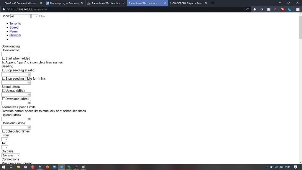

LoadModule  proxy_http_module    modules/mod_proxy_http.so
LoadModule  proxy_ftp_module     modules/mod_proxy_ftp.so
LoadModule  proxy_connect_module modules/mod_proxy_connect.so
<VirtualHost *:80 *:443>
        ServerName myusername.myqnapcloud.com
        ProxyPreserveHost On
        ProxyRequests Off
        ProxyVia Off
        <Location /owncloud>
                #Order deny,allow
                ProxyPass http://NAS_IP:Port#/index.php/login
                ProxyPassReverse http://NAS_IP:Port#/index.php/login
        </Location>
        <Proxy *>
                #Order deny,allow
                Require all granted
        </Proxy>
	SSLEngine on
	SSLCertificateKeyFile /share/CACHEDEV1_DATA/Web/192.168.1.1.key
	SSLCertificateFile /share/CACHEDEV1_DATA/Web/192.168.1.1.cert
	SetEnvIf User-Agent ".*MSIE.*" nokeepalive ssl-unclean-shutdown
</VirtualHost><e>
</e></CODE>
<IMG src="https://i.postimg.cc/0j5zwxFk/screensho ... g]</s><URL url="https://i.postimg.cc/0j5zwxFk/screensho ... pg</URL><e>[/img]</e></IMG></r>

simonwilkins wrote:
Fri Jan 31, 2020 6:27 am
<r>I am trying use reverse proxy for owncloud. I seem be able to get it working however it doesn't display the page properly when loading it on port 443. See my code below along with screenshot when attempting to load it via SSL. <br/>
<br/>
Thanks in Advance <br/>
<CODE><s>
Code: Select all
</s>LoadModule  proxy_module         modules/mod_proxy.so
</VirtualHost><e>
</e></CODE>
What's with all the inline tags? Writing a new bot? ;)
Are you forwarding myQNAPCloud traffic through your ReverseProxy?

oyvindo wrote:
Fri Jan 31, 2020 2:38 pm
Correct as owncloud doesn't provide SSL hence wanted to provide a ReverseProxy to secure it.

oyvindo wrote:
Thu Feb 13, 2020 3:54 am
I'm not familiar with OwnCloud.
One of the main purposes of implementing access through a Reverse Proxy, is to achieve a secure connection (SSL) through a single access point for any number of web based applications, especially for web apps which does not have naitive support for SSL.
My understanding of OwnCloud is that it's main purpose is to provide a cloud ecosystem for external users (?) As such, I would be very surprised if OwnCloud doesn't offer extensive mechanisms in place to secure safe, encrypted access methods (?) You can of course choose to route incoming connection requests through your own reverse Proxy with SSL support, but you must have a domain registered (Dyn-DNS). MyQNAPCloud relies on QNAP certificates. These are default included with every QNAP NAS for free, using self signed CERT. You can buy valid certificates from QNAP, and you can replace them with your own CERTs. But my advise in not to use myQNAPCloud as you Dyn_DNS. Instead, st up your own domain name and follow the security advises recommended in the OwnCloud documentation.
Even if I attempt to reverseproxy transmission via my local IP address, it still doesn't display transmission properly as seen on the image below
Thanks in advance.
